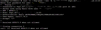

Are ports 21 and 22 open on your server, the local firewall and the data center firewall for your server? Is the passive port range open in the Plesk firewall? Can you sftp or curl to the ftp storage space when trying this on your Linux console? For example:
# curl -v --ftp-pasv --ssl -k -u user 'server'
Yes, but can you write and read files? The original error message was that STOR test does not work. Can you transmit a test file and read it back?
Just wanna input if it error without reason don't forget to open port 22 if you tick this 1693471527352.png
Simply untick Use FTPS if you don't open port 22 on your server than it will work.
