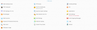

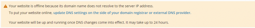

Hi,
I have manually setup DNS in Cloudflare for several websites on my plesk server as Domain Connect doesn't work and appears to be a known issue.
My websites are up and working but in Plesk I get a warning that my websites are offline because the domain is not resolvable. I'm guess this is becasue Cloudflare points inbound traffic to it's own cache server IPs and not my physical server ip?
Main thing is my sites are working but I wondered if this will cause other issues if Plesk cannot see me true DNS records and if there is a way to fix this? I've tried with DNS enabled / disabled / pointed at Cloudflare and it still gives the warning.
Thanks for any help /advice.
Ed

Any way to have Plesk be more intelligent about detecting Cloudflare and not displaying this warning when this very popular proxy is being used? Instead of turning it off globally for all websites... :)
