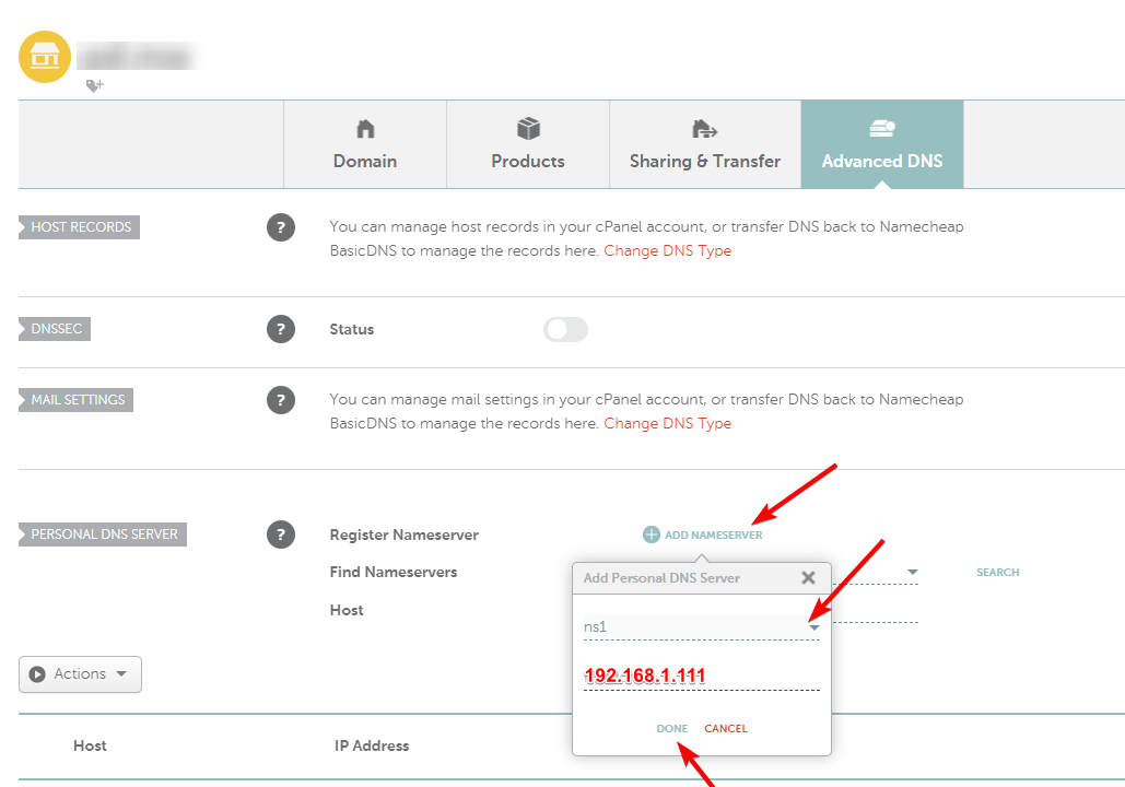

Looks like you're using namecheap for your domain. In this case, did you went to name cheap and added it under the "Personal DNS Server"? (You will need to go to the Advanced DNS in your registrar and choose to add a nameserver under the Personal DNS Server section for Register Nameserver).
Here's a screen shot to give you an idea of what it'll look like:
raw
Once they're added, under the "Find Name Servers", if you click search you should see your name servers listed. If they're not listed then you didn't create the glue records.
