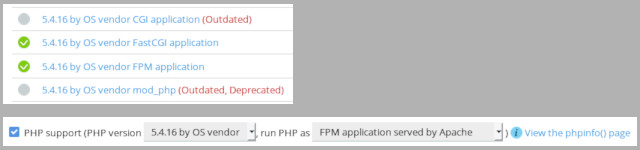

This is how it looks on our CentOS 7 / Plesk 17.8.11 servers:
I remedied the situation before our customers ever had a chance to notice.
I don't dream of showing them the word "Outdated" for something that a) isn't outdated b) they are paying us to take care of c) ... Well, we just like to keep our customers.
