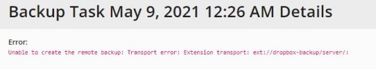

I have the following error on the Plesk Backup page:
"Warning: Could not display the list of backups in the Dropbox Backup storage: Unable to get dumps list: Transport error: Extension transport: ext://dropbox-backup/server:. Please check the storage settings."
In addition, for the past few days (out of the blue):
"The backup May 4, 2021 12:26 AM was not created. Download the log file View the log Close this message"
The log states:
"Error:
Unable to create the remote backup: Transport error: Extension transport: ext://dropbox-backup/server/:"
When I check in the Dropbox Apps Folder, it appears that I actually do have a backup for each and every day (over 200GB - which is about right ).
I've not tried downloading the backup as of yet, but given it's size... it seems like it's making it's way up to Dropbox.
Why the errors?
Thanks for any help!
Tim.

I've attached the main page, and the log page from yesterday.

hello @Tantrumedia ,
I'd suggest to check manual execution exactly for server backup.
the reason of failure can be with too large size or too much objects that should be processed.
Additionally I'd suggest to re-add dropbox cloud storage for server backup: make log-out first and then configure it again. Probably something goes wrong with authorization token.
As you said that list of backups loading too slow there also may be connectivity problems between very this Plesk server and dropbox infrastructure.

Hi Nik,
Answers to your points.
Manual backup works 100% - zero errors. But this was on a smaller subset of data.
I've tried removing and re-adding Dropbox in the past, didn't seem to make any difference, but I can try again.
I've changed the [ext-dropbox-backup] values to those suggested, and even higher.
I'm downloading the 200GB+ backup from Dropbox to see if it's actually fully intact - I suspect it is, and there's just some kind of I/O issue with final confirmation. Maybe hash created at the start, times out or something?
As for a new backup starting before an old one finishes, Dropbox will indeed create a new version of the file with the same name ( the other will fall into the history ).
I do wonder if it's possible to do regular backups every 2 days in Plesk? I could only find daily and weekly.
Thanks for taking the time to reply!
Tim.
