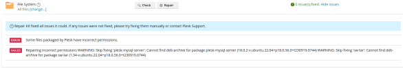

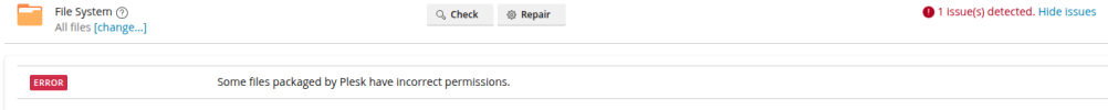

Hello,
I have been experiencing a problem for a long time in Diagnose & Repair → File System.
Some files packaged by Plesk have incorrect permissions.
Repairing incorrect permissions
WARNING: Skipping 'plesk-mysql-server': Cannot find deb-archive for package plesk-mysql-server (18.0.2-v.ubuntu.22.04+p18.0.56.0+t230919.0744)
WARNING: Skipping 'sw-tar': Cannot find deb-archive for package sw-tar (1.34-v.ubuntu.22.04+p18.0.56.0+t230919.0744)
Can anyone help me?
Thank you.
Screenshot from 2025-08-17 22-05-41.pngScreenshot from 2025-08-17 22-08-05.png
Looks like the packages installed is not the same as the current version of Plesk as seen in the package names.
As a start you can try running apt clean to clean current packages then run apt update to get updated packages.
You could also try to follow the instructions listed in https://support.plesk.com/hc/en-us/...eb-archive-for-package-plesk-backup-utilities but replace the plesk-backup-utilities with plesk-mysql-server and sw-tar. But you will also need to find the packages on Index of /
Otherwise you can try to reinstall Plesk as if you're doing an upgrade by following the directions at Upgrading Plesk for Linux Using Installer Console
@othmaqsa , as of Plesk Obsidian 18.0.72, you should no longer see the false-positive warnings about the 'sw-tar' and 'plesk-mysql-server' packages.
