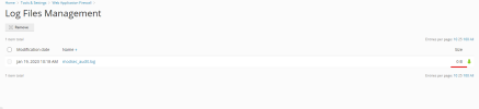

When I try to check the logs in ModSecurity Log File or Logs Archive, it shows a blank page, it doesn't show any logs.

Some Logs are showing currently since 2 days. So normally, the ModSec is working now.
