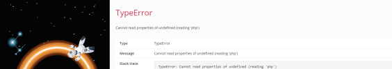

I have issue with creating new domain... Error happens during creating physical hosting
Creating physical hosting
flock(): Argument #1 ($stream) must be of type resource, bool given
Second issue is that I can't change PHP versions. Getting some weird error

Let's check the PHP issue first, because that could also lead to the other issue. Could you please copy the content of the "php" section of /usr/local/psa/admin/conf/panel.ini to a post here? Was that file modified manually before?

Here are entries in log
Code:
[2023-07-24 11:05:50.878] 2330864:64be30ded65d5 DEBUG [util_exec] [42c26bea783af2d8ef6969568f6a7b02-0] Starting: phpinimng --status --type=fpm --service-name=plesk-php74-fpm_hooldusraamat.ee_73
[2023-07-24 11:05:51.118] 2330864:64be30ded65d5 DEBUG [util_exec] [42c26bea783af2d8ef6969568f6a7b02-0] Finished in 0.2405s, Error code: 0
[24-Jul-2023 11:05:51 Europe/Tallinn] PHP Warning: fopen(/run/lock/files/plesk_restart_apache.lock): Failed to open stream: Permission denied; File: /usr/local/psa/admin/plib/Service/Driver/Web/Server/Restartable.php, Line: 48
[2023-07-24 11:05:51.120] 2330864:64be30ded65d5 ERR [panel] Exception: PHP Warning: fopen(/run/lock/files/plesk_restart_apache.lock): Failed to open stream: Permission denied; File: /usr/local/psa/admin/plib/Service/Driver/Web/Server/Restartable.php, Line: 48
file: /usr/local/psa/admin/plib/Smb/Exception/Syntax.php
line: 56
code: 0
trace: #0 (0): Smb_Exception_Syntax::handleError(integer '2', string 'fopen(/run/lock/files/plesk_restart_apache.lock): Failed to open stream: Permission denied', string '/usr/local/psa/admin/plib/Service/Driver/Web/Server/Restartable.php', integer '48')
#1 /usr/local/psa/admin/plib/Service/Driver/Web/Server/Restartable.php(48): fopen(string '/run/lock/files/plesk_restart_apache.lock', string 'r')
#2 /usr/local/psa/admin/plib/Service/Driver/Web/Server/Restartable.php(15): Service_Driver_Web_Server_Apache->_isRestartLocked()
#3 /usr/local/psa/admin/application/smb/controllers/WebController.php(669): Service_Driver_Web_Server_Apache->getRestartInterval()
#4 /usr/local/psa/admin/application/smb/controllers/WebController.php(652): Smb_WebController->getRestartApacheIntervalWhenChangingPhpHandler()
#5 /usr/local/psa/admin/plib/vendor/plesk/zf1/library/Zend/Controller/Action.php(516): Smb_WebController->phpSettingsAction()
#6 /usr/local/psa/admin/plib/vendor/plesk/zf1/library/Zend/Controller/Dispatcher/Standard.php(308): Zend_Controller_Action->dispatch(string 'phpSettingsAction')
#7 /usr/local/psa/admin/plib/vendor/plesk/zf1/library/Zend/Controller/Front.php(954): Zend_Controller_Dispatcher_Standard->dispatch(object of type Zend_Controller_Request_Http, object of type Zend_Controller_Response_Http)
#8 /usr/local/psa/admin/plib/Application/Web.php(48): Zend_Controller_Front->dispatch(object of type Zend_Controller_Request_Http)
#9 /usr/local/psa/admin/htdocs/application.php(15): Plesk\Application_Web->run()
[2023-07-24 11:05:51.120] 2330864:64be30ded65d5 DEBUG [panel] Execute: '/usr/local/psa/admin/bin/send-error-report'
[24-Jul-2023 11:05:51 Europe/Tallinn] PHP Warning:  fopen(/run/lock/files/plesk_restart_apache.lock): Failed to open stream: Permission denied in /usr/local/psa/admin/plib/Service/Driver/Web/Server/Restartable.php on line 48
[2023-07-24 11:05:51.328] 2330864:64be30ded65d5 ERR [panel] flock(): Argument #1 ($stream) must be of type resource, bool given:
0: /usr/local/psa/admin/plib/Service/Driver/Web/Server/Restartable.php:49
    flock(boolean false, integer '6')
1: /usr/local/psa/admin/plib/Service/Driver/Web/Server/Restartable.php:49
2: /usr/local/psa/admin/plib/Service/Driver/Web/Server/Restartable.php:15
3: /usr/local/psa/admin/application/smb/controllers/WebController.php:669
4: /usr/local/psa/admin/application/smb/controllers/WebController.php:652
5: /usr/local/psa/admin/plib/vendor/plesk/zf1/library/Zend/Controller/Action.php:516
6: /usr/local/psa/admin/plib/vendor/plesk/zf1/library/Zend/Controller/Dispatcher/Standard.php:308
7: /usr/local/psa/admin/plib/vendor/plesk/zf1/library/Zend/Controller/Front.php:954
8: /usr/local/psa/admin/plib/Application/Web.php:48
9: /usr/local/psa/admin/htdocs/application.php:15
[2023-07-24 11:05:51.328] 2330864:64be30ded65d5 ERR [panel] TypeError: flock(): Argument #1 ($stream) must be of type resource, bool given
file: /usr/local/psa/admin/plib/Service/Driver/Web/Server/Restartable.php
line: 49
code: 0
trace: #0 /usr/local/psa/admin/plib/Service/Driver/Web/Server/Restartable.php(49): flock(boolean false, integer '6')
#1 /usr/local/psa/admin/plib/Service/Driver/Web/Server/Restartable.php(15): Service_Driver_Web_Server_Apache->_isRestartLocked()
#2 /usr/local/psa/admin/application/smb/controllers/WebController.php(669): Service_Driver_Web_Server_Apache->getRestartInterval()
#3 /usr/local/psa/admin/application/smb/controllers/WebController.php(652): Smb_WebController->getRestartApacheIntervalWhenChangingPhpHandler()
#4 /usr/local/psa/admin/plib/vendor/plesk/zf1/library/Zend/Controller/Action.php(516): Smb_WebController->phpSettingsAction()
#5 /usr/local/psa/admin/plib/vendor/plesk/zf1/library/Zend/Controller/Dispatcher/Standard.php(308): Zend_Controller_Action->dispatch(string 'phpSettingsAction')
#6 /usr/local/psa/admin/plib/vendor/plesk/zf1/library/Zend/Controller/Front.php(954): Zend_Controller_Dispatcher_Standard->dispatch(object of type Zend_Controller_Request_Http, object of type Zend_Controller_Response_Http)
#7 /usr/local/psa/admin/plib/Application/Web.php(48): Zend_Controller_Front->dispatch(object of type Zend_Controller_Request_Http)
#8 /usr/local/psa/admin/htdocs/application.php(15): Plesk\Application_Web->run()
[2023-07-24 11:05:51.328] 2330864:64be30ded65d5 DEBUG [panel] Execute: '/usr/local/psa/admin/bin/send-error-report'
Rights issue? this file has 600
I think it is safe to delete /run/lock/files/plesk_restart_apache.lock. However, there is a reason why a lock is present. Probably a service hung or still hangs, and you can either determine which one it is and restart it or you can try to reboot the whole server so that all services restart the way they should. It is also thinkable that due to the "multi"-problem situation, the Plesk installation was damanged or file permissions were modified that Plesk cannot work properly. If you suspect that this could be the case, a "# plesk repair installation" might fix the issue. Bottom line if it was my own server: I'd probably first try to remove the .lock, then reboot the whole server (because probably some situation caused services become unresponsive) and also try the repair (in this order).
If this does not feel comfortable to you (because there are always risks with reboots), you could also open a ticket with Plesk support and let them look into your server by SSH. They might identify the cause individually and fix it without reboot.
