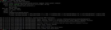

Last Night Upgraded to latest Mariadb 11.4.7 version and to the latest Plesk Obsidian 18.0.72 version
Prior to that I've Installed Varnish varnishmng.sh to test it on my Domains.
All worked fine and enabled / Disabled Varnish on Domains and Subdomains for testing.
The problems started when Upgraded to latest Mariadb 11.4.7 version and to the latest Plesk Obsidian 18.0.72 version
Since then all domains and Subdomains configuration messed up with apache2 Configurations and all webpages went on redirection loop.
Now is impossible to use varnishmng.sh to enable or disable varnish cache on domains withour errors >> mysql: Deprecated program name. It will be removed in a future release, use '/usr/bin/mariadb' instead
As you see above the Varnish is working but if I disable cache on domains they become unreachable as you see below..
Also I can't use Nginx as proxy because I get almost the same issue.
