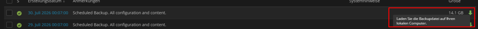

I would like to add another observation that may help narrow down the issue.
The problem is not limited to exporting the backup to the remote repository. Downloading the backup directly through the Plesk Backup Manager also fails.
Plesk lists the backup as successfully created with an expected size of approximately 14.1 GB. However, after clicking the download button, the browser immediately finishes downloading the following file:
Code:
backup_2607300007.tar
The downloaded file is only 1,191 bytes in size instead of the expected 14.1 GB and is not a valid TAR archive.
The successfully created 14.1 GB backup in the Plesk Backup Manager:
The completed browser download with a file size of only 1,191 bytes.
The actual backup data in DUMP_D exists and was created successfully. However, Plesk is apparently unable to read or stream the backup correctly when the download is started.
This behavior seems consistent with the remote export issue described above, where pmm-ras also stops after transferring approximately 1,024 bytes. Therefore, the issue does not appear to be limited to FTP or FTPS. It may instead affect the backup staging or download process when DUMP_D and DUMP_TMP_D are located on the SSHFS/FUSE mount.
I also inspected the downloaded 1,191-byte file.
It does not contain any backup data. The file consists of exactly 1,024 zero bytes, followed by the following plain-text error message:
Code:
Repository error: Failed to open the file '/mnt/sshfs/xxx/DUMP_TMP_D/pmm-de-tmp-repo-xxxxxx/backup_ext_dist_kernelcare-plesk_2607300007.tzst': Operation not permitted
The first 1,024 bytes correspond to two empty 512-byte TAR blocks. Therefore, the downloaded file is effectively an empty TAR archive followed by the repository error message.
This also directly matches the 1,024 bytes reported by pmm-ras during the failed remote export.
It confirms that Plesk fails while opening a file from DUMP_TMP_D on the SSHFS/FUSE mount and returns the repository error instead of the actual backup data.
