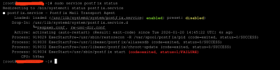

# systemctl status postfix.service
● postfix.service - Postfix Mail Transport Agent
Loaded: loaded (/usr/lib/systemd/system/postfix.service; enabled; preset: disabled)
Drop-In: /usr/lib/systemd/system/postfix.service.d
└─respawn.conf, rw-usr-dir.conf
Active: activating (auto-restart) (Result: exit-code) since Tue 2026-01-20 19:56:15 UTC; 1s ago
Process: 1168303 ExecStartPre=/usr/sbin/restorecon -R /var/spool/postfix/pid (code=exited, status=0/SUCCESS)
Process: 1168304 ExecStartPre=/usr/libexec/postfix/aliasesdb (code=exited, status=0/SUCCESS)
Process: 1168306 ExecStartPre=/usr/libexec/postfix/chroot-update (code=exited, status=0/SUCCESS)
Process: 1168307 ExecStart=/usr/sbin/postfix start (code=exited, status=1/FAILURE)
CPU: 600ms
At a loss how to resolve this.
