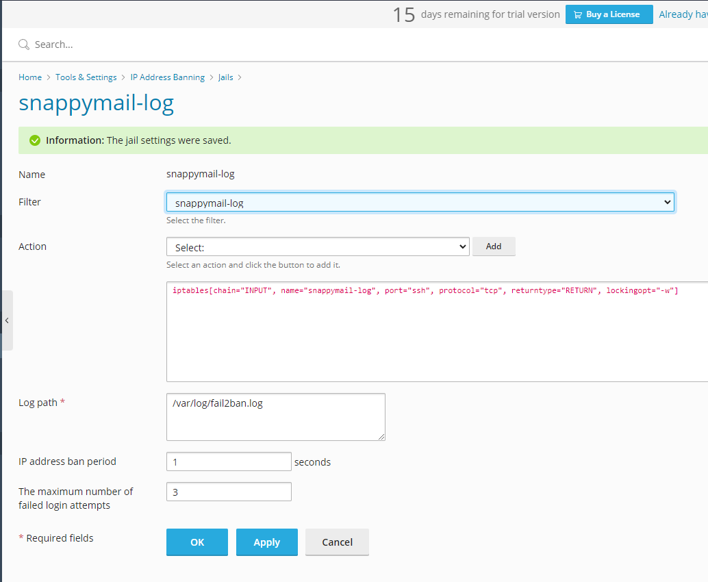

So, without going out of the way to do the full installation in a test environment, the only thing I can say is to make sure you configure your jails properly. Here's how I got it configured in my test:
raw
Make sure that the log path is correct for where the logs are configured for snappymail.

In Log path I was try to insert the path to the fail2ban log folder inside the snappy mail and Plesk give me an error, now that I use your path var/log/fail2ban.log I am able to create the two jails but when a wrong login in snappy mail is done no custom log is created.

I just used /var/log/fail2ban.log as an example, you will need to make sure the log file you're using is the correct one with the correct path that exist so you want to check that and update accordingly.
Finally discovered the log file should be compiled as you compiled it: /var/log/fail2ban.log
The custom file log that I mean and it's saved will be created by the snappy fail2ban app (confi, application.ini) that is where user set the patch of the custom log.
Plesk need have /var/log/fail2ban.log in the UI settings, that's good.
This post just to made the discussion updated so in the future I hope to don't fall anymore into this issue.
I updated also my instructions on the GitHub issue of the app and the configuration of fail2ban.
Not correct, I need revert back log with custom path.
If I use the plesk log location the ban never work, the app save the fail2ban inside the app folder so need use custom path and be sure the log file exist and is not deleted. Will correct again the GitHub page,
