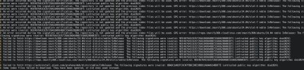

Here is a detailed screenshot of how it looks like:
@LionKing our team is already working on updating the signing key. The case is currently in the testing phase and the fix should be released in the upcoming days.

@Michael Poellath , thank you for the update. The issue related to Imunify's repository has already been brought to CloudLinux's attention. About PHP 7.4 and PHP 8.0, I believe it is normal for the warning to appear since they are already EOL. Still, our team is currently reviewing the case and I will follow up with more details as soon as possible.

W: An error occurred during the signature verification. The repository is not updated and the previous index files will be used. GPG error: Index of /grafana/deb stable InRelease: The following signatures were invalid: 8BADC1A02FC9C07FB8C20EC0BD11A6AA914BDF7E (untrusted public key algorithm: dsa1024)
If you have automatic updates enabled in Plesk, you will get sent a mail noting that the updates failed every day, as these warnings are considered an error for that purpose.
Since 31.05.2025 we have the same issue on the server with Ubuntu 24.04.2 LTS and Plesk Obsidian 18.0.70 Web Pro Edition. It is not possible to update the available packages any more.
See the output of "apt update" in the attached files.
The root cause seems to be that Plesk and Imunify360 repositories are signed with an outdated and insecure DSA 1024-bit key, which Ubuntu 24.04 now rejects for security reasons. So, we should wait for Plesk and Imunify360 to update their repository signing keys.
Dear Plesk, please fix this issue as soon as possible.
