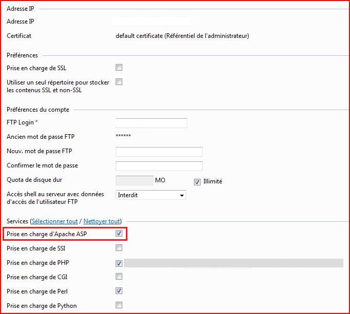

I will transfer a site hosted on a Windows server IIS 6.0. From plesk, we activated the ASP on the domain, then upload all the files and folders. (see http://www.easy-upload.net/fichiers/_asp.2010419101543.jpg)
