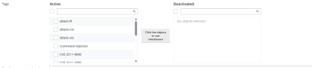

We’ve been troubleshooting an issue where ModSecurity simply refuses to trigger or apply the Atomic Advanced Ruleset on our Plesk Obsidian (latest build) server running AlmaLinux 9. The license is active and confirmed under Tools & Settings → Web Application Firewall, set to “Atomic Advanced (bought from Plesk)” with the mode set to “On (Blocking)”.

Despite all that, the Atomic ruleset never appears as installed —
plesk sbin modsecurity_ctl --ruleset-installed --ruleset atomic returns not installed, and trying to install it results in MODSEC_VENDOR_LOGIN exit status 1.
We’ve verified outbound connectivity, confirmed the Plesk license is active, and validated that the server can reach both Plesk and Atomic endpoints. At this point, it feels like Plesk isn’t actually pulling the ruleset from Atomic even though the license is valid.
