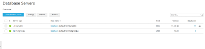

Hello, @papahausa . Could you please confirm the MariaDB version on your server and share the content of the /etc/my.cnf file?
