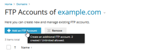

Can you please confirm the method used to connect to the server? FTP/S access is chrooted to the webspace and for additional FTP users to the designated folder within the webspace when creating them.
