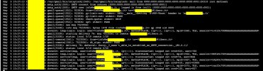

Below are the logs /var/log/maillog .
I've tried sending a mail to an address that never receives mail from the server.
I state that the sending takes place through the roundcube webmail.

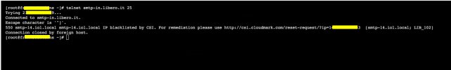

The message explains well why your server cannot connect to the target host. It is blocked by the target host.
Simply go to https://csi.cloudmarkc.om/reset-request/?ip=<your host's ip> to unblock it or ask the recipient domain owner to do that for you.
