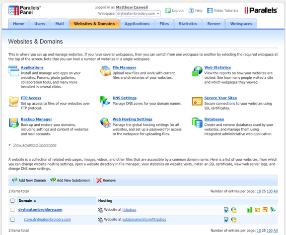

I'm on 10.3.1 and don't ever see that screen. I have attached a link to a screenshot of what I see. I can't thank you enough for wasting your time on me.
https://lh3.googleusercontent.com/-whUtvX6wTmA/T0UrWvHb9qI/AAAAAAAADZw/7t03sxZdk-0/s576/pleskscreenshot.jpg
Please, click on the "DNS Settings" showed in that screen, 2nd row, 2nd column, under "file manager", next to "FTP Access" and show me the next screen. (see attached)
