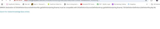

Resolved Plesk extensions not working
it ddidnt work, I can no longer search DNSSEC in Plesk Extension. And both database process list and process list can no longer be openned. I think I need Plesk support to SSH to the server. Will reinstall plesk solve this problem without affecting the current domain and mysql database?
Screenshot 2025-09-18 180420.jpgScreenshot 2025-09-18 180250.jpg to solve this problem

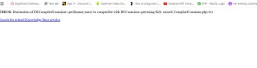

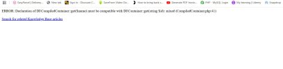

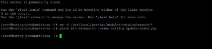

After removed all the extensions, I tried to install Let's Encrypt and DNSSec. But cannot install DNSSex
Could not install the Plesk DNSSEC extension
The execution of post-install.php has failed with the following message:
PHP Fatal error: Declaration of DI\Definition\Source\NoAutowiring::autowire(string $name, ?DI\Definition\ObjectDefinition $definition = null) must be compatible with DI\Definition\Source\Autowiring::autowire(string $name, ?DI\Definition\ObjectDefinition $definition = null): ?DI\Definition\ObjectDefinition in /usr/local/psa/admin/plib/modules/dnssec/vendor/php-di/php-di/src/Definition/Source/NoAutowiring.php on line 17
My personal guess is that the extension catalog got corrupted by some reason. However, since you already tried re-installing it and that did not solve the issue, unfortunately, I am out of suggestions what else you could try. It will be best to consider getting in touch with Plesk support for further investigation directly on your server.
