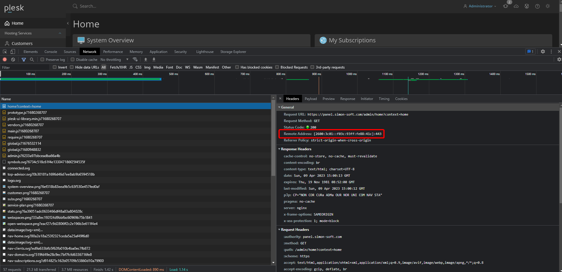

Yeah it's like what Peter said, we basically need to see the full picture with how everything is configured. As I said I am not having the issue myself as seen in this screenshot:
