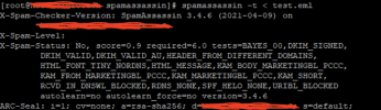

Hi @Kaspar @Sebahat.hadzhi @IgorG
I have been tweaking a lot of the Spam Assassin scorings, but it seems they are not used (files at /etc/mail/spamassassin/ & /usr/share/spamassassin/).
When I run the manual check against the header using: spamassassin -t < test.eml, it tells me different
But the actual headers of the mail that I received had a different story to tell i.e. it was not marked as spam.
Is it because i'm using the Plesk Email Security Plugin (Free Edition)? If yes, then how to fix it (without removing the plugin)?

@AK_learner, you'll need to restart Amavis (sudo systemctl restart amavis) each time you change the SpamAssassin config so it can load the new changes you made into the running deamon.
@Kaspar
The difference of the score.
Header of the email indicate the score in -2.348 whereas same email's .eml when checked against spamassin scoring via CLI shows 0.9.
Why such difference?
Well, that's for you to find out. Because without access to your server I wouldn't be able to say.
Compare each rule and the associated score listed in the header of the messages and those listed from command line to see where they deviate. The detailed content analysis on command line is shown at the end of the output.
Small side note; it's not recommended the edit files or add custom configuration files from/to the /usr/share/spamassassin/ directory. Those will be lost whenever SpamAssasin gets updated. Instead use the /etc/mail/spamassassin/ directory.
