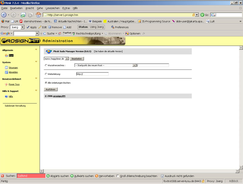

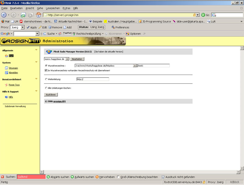

Hi Folks,
after I went mad with the FU***** Plesk subdomain handling I wrote addon for Plesk.
With the "Plesk Sudo Manager" you can manager your Subdomains.
- make easy a forward
- change the webroot to a existing dir of your "normal" webspace in "YOU/PATH/DOMAIN/httpdocs"
In the attachment you can find the first version to test it on you maschine.
Screenshots:
Download:
http://www.haggybear.de/download/sudo.zip
Cya Haggy
