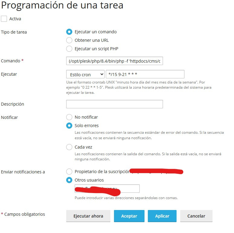

When a subscription is suspended, all scheduled tasks created under it are deactivated. That's correct, but when the subscription is reactivated, although the scheduled tasks that were active are reactivated, they lose their original formatting and associated comments.

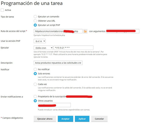

Create a cron using execute PHP script with argument
Example:
httpdocs/cms/crontabs/cron_php.php argument_value
Notify users of available replacement products for created requests // this is a comment
*/15 9-21 * * *
Suspend the subscription
Reactivate the subscription again
Check the scheduled tasks page
Edit 1 scheduled tak

(/opt/plesk/php/8.4/bin/php -f 'httpdocs/cms/crontabs/cron_php.php' -- 'argument_value') */15 9-21 * * *
EXPECTED RESULT

On a side note, according to one of the screenshots the configuration appears to be "Run as command" - when PHP scripts are being used, it is best to stick to the "Run as PHP script" option:
Hi, my PHP cronjobs were created as PHP Script but they automatically have converted to Run as command where the subscription was activated again... That it why I opened this report. I don't understand your side note... The screenshots are ok. The first is THE ACTUAL RESULT -crons converted by Plesk- and the second THE EXPECTED RESULT -cron reconfigured by me-.
And I add information, where this happens, if you run the contab manually it won't work... So I have to modify all my crons manually to restore them.
I think you misunderstood my post... The crons change from PHP Script to Run as Command where you deactivate and reactivate a subscription... That's the problem, not the comment lost (what happens too).
Thank you for the update and clarification. My point is, that if you do not interact with the scheduled tasks while the subscription is in suspended state, the issue should not occur. Nevertheless, this is just a workaround suggestion until our team introduce an official fix for the issues. They already determined the root cause of the issue thanks to your report and, hopefully, the fix will be introduced soon. Thank you once again for bringing our attention to the issue.
