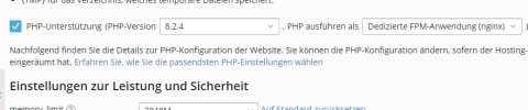

According to the list, none of the 8.1 handlers are in use, but 8.2 handlers are basically enabled. Now the question is which handler is selected on your PHP page of the subscription?
