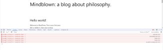

Hi,
Yesterday I upgraded MariaDB from 10.3.9 to 10.6.15 and it went well.
But since when I want to install a CMS like Joomla, Prestashop or WP I have errors on js files (See attachment
Did the upgrade cause these errors? If yes, how to correct them?
Thanks for your help.

But I still have this problem with js files, I just tried to install Joomla5 and lots of errors. I don't understand, because before the MariaDB upgrade I didn't have a problem. Now it might be something else, but what?

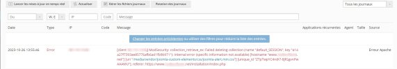

Hello Peter,
Thank you for your help.
I didn't find any missing files, but I no longer have yesterday's error in the logs but just this one:
