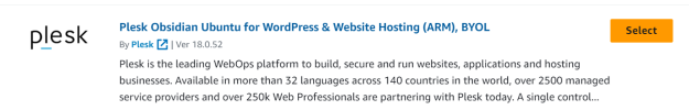

i can't install plesk premium email necessary packages on fresh setup that i use plesk obsidian ubuntu (arm) image provided by plesk in aws marketplace.

plesk support's reply is as follows: plesk premium email extension is only available for x86 architecture.
so it doesn't work for me beacuse my server is with arm architecture.
