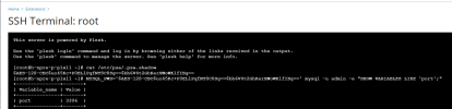

We have plesk installed in both Linux & Windows server. While we check plesk internal database in linux it's using 3306 port number but in windows it's using 8306 port number. May I know the reason for this?
Also, we have an doubt that since the plesk will not officially support port change how come this possible. Also, while we check from front end database server section it shows 3306 port number for all as attached.

On Windows Plesk runs it's own separate database server (Plesk SQL server) for the Plesk (PSA) database on port 8306. All other database run default MariaDB server on port 3306, which is shown in UI.
Hello Support,
Both plesk windows and linux server uses PSA database. If windows using PSA database and it's port number 8306 then same PSA database was also used by linux then here how come the database port was 3306?
