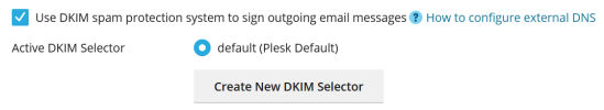

Regarding the DKIM signature, is the senderAddress in panel.ini a local address with DKIM signing enabled for it?
Local address, yes, insofar as the senderAddress email domains have a subscription/domain setup on the same Plesk server (each server has a different domain), with DKIM signing enabled using this UI configuration:
The only exception is that of the server whose email source output I quoted. It does not have senderAddress set in Panel.ini, so it sends as the Plesk profile email address (which is a domain in Plesk with DKIM enabled in mail settings).
All other known email notifications (auto-update etc.) are passing DKIM checks, as expected. All these Anacron messages fail DKIM checks.
