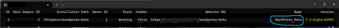

Non-SemVer version numbers​
The list entry with the name WordPress Beta and the specific version number 7.1-alpha-62492 is a clear indicator that the WP Toolkit has an issue with non-semver version numbers.

Likely few users might be using alpha/beta versions of WordPress and therefore it might seem like an edge case, but if only one site has a non-semver version number the WP Toolkit becomes unusable which defeats the purpose of using it.

Thank you for the confirmation. It's probably a database inconsistency and the article you linked earlier should help resolve it. Please try following the steps for the website returning the Invalid argument not valid semver error. If that solution doesn't help sorting it out, please double-check /var/log/plesk/panel.log for extension/wp-toolkit related errors.
