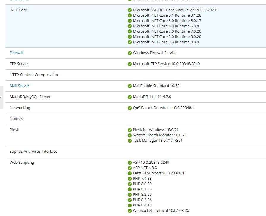

We have Plesk Windows server and installed with ASP.NET. In the admin panel it shows only 4.8 version as the web scripting in Server components. Also, in server components I have the below .NET core components are shows.
When I tried to create the website, the 4.8 version only shows. There is no dropdown option for other 6.0 or 7.0 version shows.
I have tried to create the sample website and it shows version v4.0. But in the runtime.json file shows 8.0 version.
Can you please let me know how to select the version manually to install the website with that particular .Net version?

Thanks for your reply. As you see the above screenshot in the link, the .net core has been installed in our server. But our concern is, how can we choose the core version for the website?

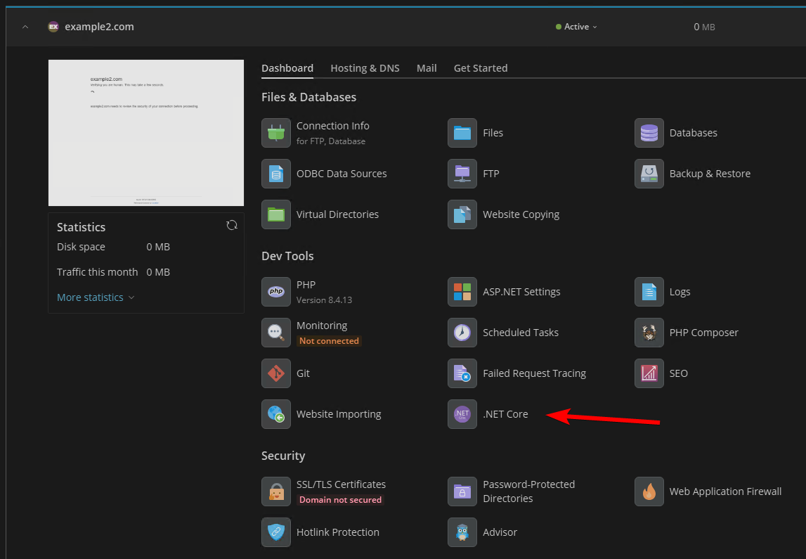

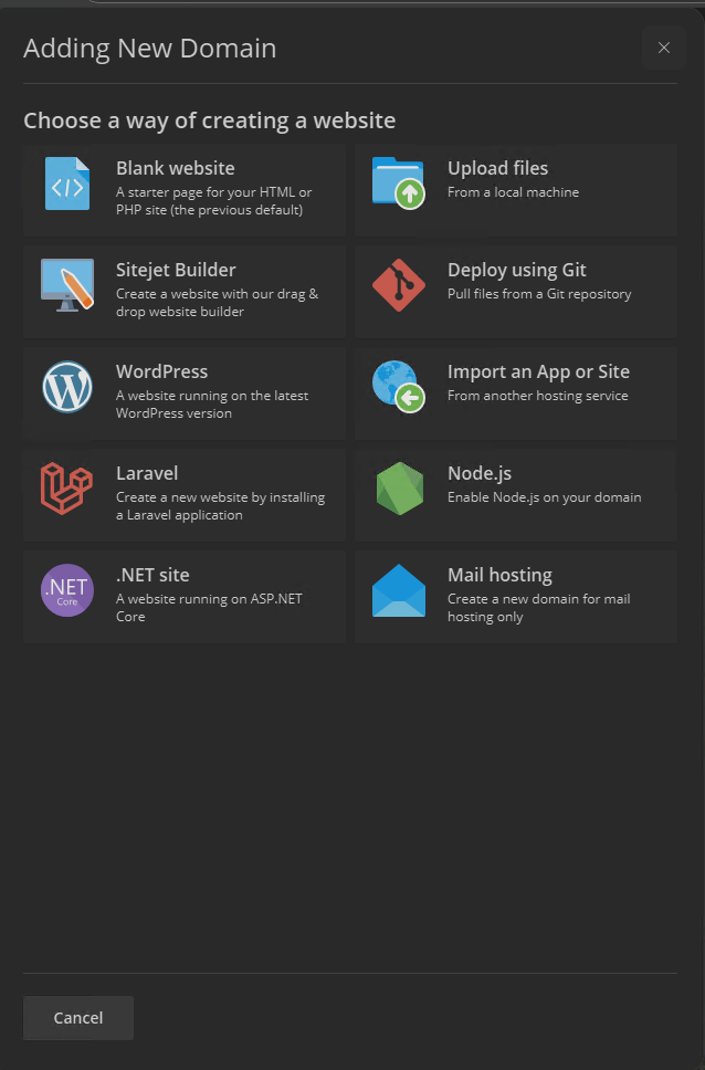

So I did another test. The first time I set it up I added a domain before I added the .NET Core component. When I go add another domain, it gives you the option to deploy an ASP.NET Site which uses .NET Core which gives you an extra icon whereas doing the first way I provided does not give you that extra icon.
