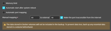

This is a docker thing not a Plesk thing. You would want to expose a port that is map to a port in the container itself then create the proxy to said exposed port of the container.
For example, let's say you are running a container which has it's own web server running on port 80. Since port 80 is used by Plesk you would need to expose a different port that is map to port 80. Here's a screen shot of how one of mine is set up as: 1750779294189.png
In this example I have port 90 exposed to the host that is mapped to port 80 of the container. This will then allows me to create a docker proxy on my domain to proxy it to said container (you could also just add a custom nginix directive to do the proxying as well like I did with another container).
Hope this explains it.

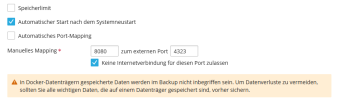

Hi @scsa20,
thank you for your reply and for sharing the screenshot.
Let me clarify: The port mapping (e.g. 8080:4323) and the Reverse Proxy via domain are both correctly configured — please see the attached screenshots below.
The actual issue is not the port mapping or the proxy setup.
Instead, it's a recurring DROP rule in iptables that is automatically set against the Docker container's internal IP (e.g. 172.17.0.2).
