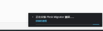

When
I click on install extension, it never completes. The task queue in the bottom right corner is always running.
How can I fix this issue and stop showing the task queue?
The Plesk Migrator extension has been manually removed using the command line.
However, the internal server error is still displayed on the extension page.
How can I fix this? Thank you.

Plesk Obsidian version 18.0.56
When I click to install an extension, it never completes. The task queue in the bottom right corner keeps running.
How can I troubleshoot this issue and stop the task queue from showing?
The Plesk Migrator extension has already been manually removed using the command line.
However, on the Extensions page it still shows Internal Server Error.
How can I resolve this problem? Thank you.

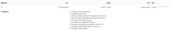

Hello, @hzl . Can you please navigate to Tools & Settings > Info and Statistics and confirm if there a sufficient amount of available disk space?
Thank you for your reply.

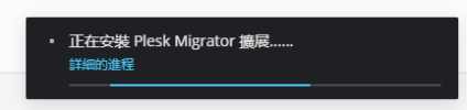

Thank you for the update. Please connect to the server via RDP, search for services.msc, and restart the Plesk Task Manager service. I would also like to confirm if you have added any antivirus software prior to the occurrence of the issue.
Restart the Plesk Task Manager service.
The problem in the lower right corner persists.
I don't have antivirus software installed. I only installed Trend Micro antivirus after the problem occurred.

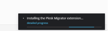

Sorry, @hzl . What does that message say exactly? Is that the notice for the extension installation and does the process get stuck again? Also, does the Extensions page open properly now?
The Extensions page can be opened.
The extension installation and process continues to get stuck
This image shows the message: Install Plesk Migrator Extension NOW.
