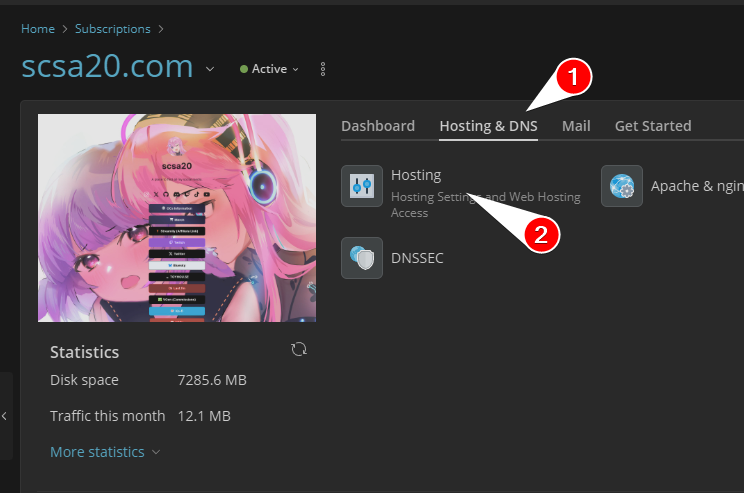

Just need to go to the domain > Hosting & DNS > Hosting
raw
Scroll down to SSH access and set the type then save

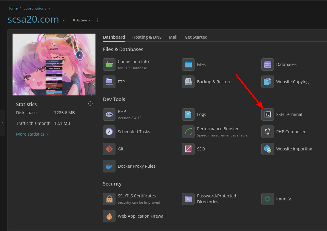

Once it's enabled, switch back to Dashboard and you will now have the SSH Terminal button.
raw
Click on that to get access to the terminal and you can do whatever (this is done at the user level of the domain thus why I recommend it doing this way to ensure proper permissions and what not).
