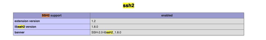

Thank you I installed it according to your instructions, i can see the ssh2 extension in the phpinfo page. But im getting the following error, i restarted apache as well.
Code:
Call to undefined function  ssh2_connect()
PS: Not sure if it matters but under PHP extensions in Plesk i dont see the ssh2 checkbox

Update: I can see the "ssh2" checkbox under Plesk settings and its enabled but i still do get the error
"Fatal error: Uncaught Error: Call to undefined function ssh2_connect()"
PHP 7.4 FASTCGI

SSH2 managed to work, the user that is running the PHP Script is not root but is the webadmin of that domain (domain1.com) - is it still a security issue?
