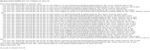

Hello Support,
We are using the secure environment (Offline server) and we have allowed the particular URL only to install the plesk in the server. When we try to install the Plesk, it shows as EPEL required to be enabled error.
Please refer to the attached screenshot for your reference.
Note : We are unable to install the EPEL RPM directly from online in this server and it is restricted.
So, is there any possible way to achieve this?
Awaiting your reply.
Hello Support,
We are getting the below attached error while installing plesk in a restricted environment.
1. what will be the best way to install where firewall restricted and what are domain needs to be whitelisted?
2. how can we install where access restricted to only plesk domain names & what are the domain name to be whitelisted?
Hello,
Any update on this concern about installing plesk in restricted environment?
We are looking forward your prompt response.
Hello, @Thomas Oryon . As mentioned, by @scsa20 , the EPEL repository is required. Since your server is not connected to the internet, the connection to the repository fails. What you can try is creating a local EPEL mirror repo on another server with internet access and transferring it to your offline server. However, this is something that needs to be handled by your system administrator.
