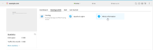

Hello,
We want to know how to disable/hide the Whois Information option in Plesk customer panel? We have already disabled the DNS in this server but how to hide this? Refer to the attached.
If there is any way to hide this option, please share the steps.

Hello Raul,
Are you referring to the below screenshot?
Awaiting you reply.

Interesting. That is a Plesk feature, but I can't get the button to show on my install.
Do you have anything in /admin/custom-buttons/list (Plesk > Tools&Settings > Plesk Appearance: Custom Buttons)?
Ah. Indeed. Thank you, @Kaspar. With "BIND DNS server" removed from
Bash:
plesk installer
the Whois button is displayed.
Without the "BIND DNS server" component installed, you don't have access to
Bash:
plesk bin subscription_settings --update example.com -manage_dns false
You can install the "BIND DNS server" and deactivate "DNS zone management" in the subscription permissions (for the Plesk user) and in Tools & Settings > Restricted view (for Plesk admin).
