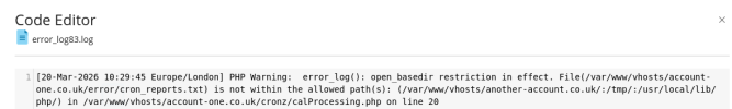

BUT the cronjob in this account dumps errors to the following location:
/var/www/vhosts/account-one.co.uk/error_log83.log
[20-Mar-2026 10:29:45 Europe/London] PHP Warning: error_log(): open_basedir restriction in effect. File(/var/www/vhosts/account-one.co.uk/error/cron_reports.txt) is not within the allowed path(s): (/var/www/vhosts/another-account.co.uk/:/tmp/:/usr/local/lib/php/) in /var/www/vhosts/account-one.co.uk/cronz/calProcessing.php on line 20

How do we get Cron Jobs to correctly identify the specific account directory? Why doesn't {WEBSPACEROOT} as per the Plesk Documentation work?!
There is no commonality between account-one.co.uk and another-account.co.uk , they're not in the same subscription, not in the same owner. Nothing.
Unfortunately (and frustratingly) Plesk doesn't load the domain specific PHP configuration when executing Cron Jobs.
I posted a possible workaround for this scenario here.

Ok, Thank you. I'll see what I can do with that, thank you @Kaspar .
However, I am still unclear how the cron job plesk runs specifically references another domain?!?! I've looked in the /etc/php.ini file which says:
Code:
open_basedir = /var/www/vhosts/account-one.co.uk/:tmp/:/usr/local/lib/php/
Which is correct.
Still very confused why PHP for the cronjob is referencing another account.
