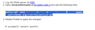

I had someone from Plesk, via IONOS say I could do this:
What I don't know, as I don't use Vi, is does this need to be exact spaces etc. It's going into the master.cf which I can open up in Filezilla?
