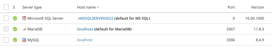

I want to configure MySQL (8 or 8.4) as the default database instead of MariaDB, what is the procedure for this:
  • On existing Plesk installation.
  • On a Fresh installation, where Plesk has not been installed yet.
OS: Windows
@Sebahat.hadzhi @IgorG any input from your end?
Hi @scsa20
Thank you for sharing this. Yes I had gone through it, but that's why my query was there.
However, if I change the default MariaDB to 3307 & set MySQL to 3306, then installation of SpamAssassin breaks, because its still trying to connect to default 3306 port, which I have now given to MySQL instead of MariaDB.
Any idea?
Yes this is because it is expecting MariaDB to be running on the default port 3306. What you should be doing is leaving MariaDB's settings alone since that's how Plesk is going to be running everything and instead set MySQL to be running on port 3307.
