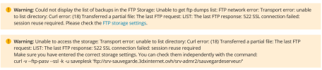

Since version 18.0.77, FTP backups no longer work, displaying the following error message:
Could not display the list of backups in the FTP Storage: Unable to get ftp dumps list: FTP network error: Transport error: unable to list directory
We have check with the command curl -v --ftp-pasv --ssl -k and everything is fine

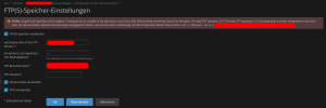

Hi, The OS is Debian other informations in Attache files. The curl command works.

Could you please confirm what's the current configuration under the Protocol Policies tab on the remote FileZilla server for the user associated with the backup that is failing?
Thank you for your response.
Current configuration under Protocol Policies on the FileZilla Server:
  • Minimum allowed TLS version: 1.2
  • Using a self-signed X.509 certificate
  • Passive mode enabled
  • Require explicit FTP over TLS enabled
Additional behavior:
If I switch the setting to "Explicit FTP over TLS and insecure plain FTP" and disable FTPS in the Plesk backups, the backup transfer works.
With "Require explicit FTP over TLS" enabled together with FTPS in Plesk, the transfer fails but only on Debian 10/11, not on Debian 12/13.
Thank you. Could you please confirm what option is selected for "FTPS (FTP over TLS) authentication" in Filezilla > Server > Configure > Users > plesk.user > Protocol policies tab?
In the settings under "FTPS (FTP over TLS) authentication", the option "Determined by groups or system policies" is currently selected.
Thank you. Would it be possible to temporary change it to "Enabled - overrides groups policies" and test again? Thank you in advance.
I have just tested it and changed the setting to "Enabled - overrides group policies" as requested, but unfortunately without success (see screenshots).
Filezilla Server Log:
After that, I reverted it back to "Determined by groups or system policies" and disabled FTPS. In this configuration, everything worked normally again (also see screenshot).

Hi,
Same issue since the upgrade to 18.0.77.
Message on the Backup Manager:
Warning: Unable to access the storage: Transport error: unable to list directory: Curl error: (56) Failure when receiving data from the peer: The last FTP request: LIST: The last FTP response: 150 Accepted data connection
Make sure you have entered the correct storage settings. You can check them independently with the command:
curl -v --ftp-pasv --ssl -k -u username 'ftp://ftpserver.net//backups//'
Running the curl command from the server perfectly list the ftp directory.
