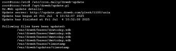

When I run
/opt/drweb/update.pl
manually on the system, everything updates fine without any error or warning.

Manually executing /etc/cron.dailty/drweb-update does work without errors.
